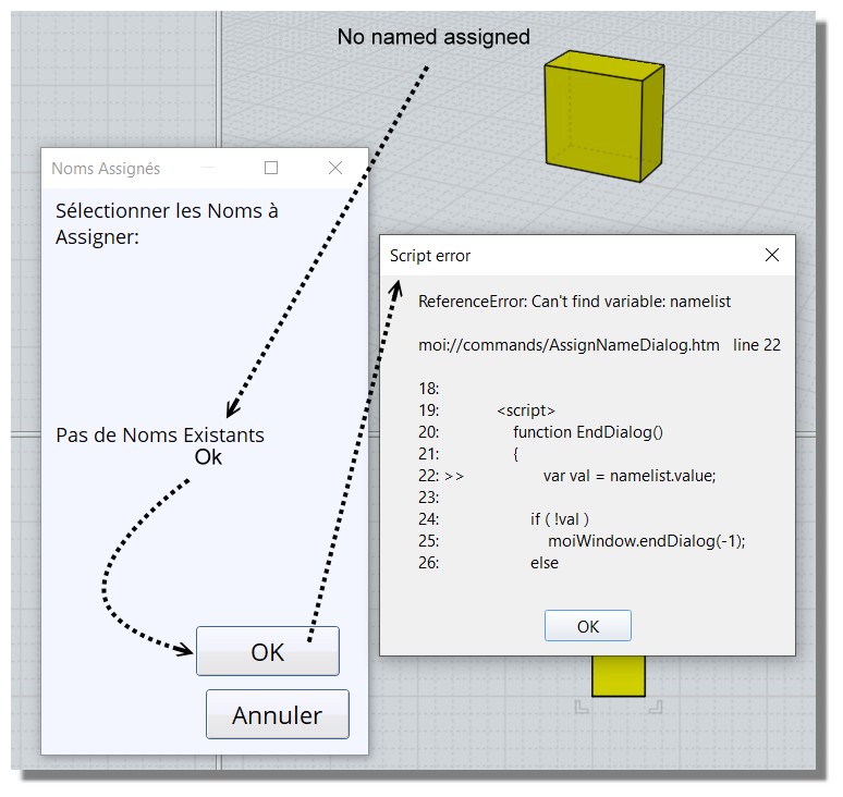

All works fine in French in V4 Beta when Names are assigned or existant
but when Names are not assigned or not existing i have that when I press OK !
http://moiscript.weebly.com/uploads/3/9/3/8/3938813/assignnamedialog.zip

9717.14 In reply to 9717.12
If there are no names present then there is nothing for the command to do and no reason to run it.
9717.15 In reply to 9717.14
So this error message is an advice and must be not taken in count. OK / Cancel is sufficient?...
9717.16 In reply to 9717.15
Hi Pilou, that script error can be fixed by updating the EndDialog function in AssignNameDialog.htm to this:

9717.17 In reply to 9717.16
Excellent! Now that works fine!
So the French versions updated! ;)
