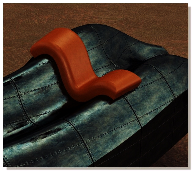

would you implement this feature?
9636.2
The Transform / Flow Function must do this... ;)
Trick is to take the target surface like a lofted or extruded surface!
EDITED: 4 Jan 2020 by PILOU
 From:  alexM3D (ALEXMAGNO3D)
9636.3 In reply to 9636.2
but not always, the target surface is extruded or loft. Unfortunately that does not solve. could have a simple option of conforming to the surface.
9636.4 In reply to 9636.3
Can you send a file 3DM with problem ?
9636.5 In reply to 9636.1
Hi Alex, yes like Pilou writes above there is a "Projective" option in Transform > Deform > Flow which works like that:
http://moi3d.com/3.0/docs/moi_command_reference8.htm#flow
A couple of notes - the target object should be smooth and all rays from the "base plane" should hit the target object.
If you are having a problem with it please post the .3dm model file with your objects in it.
