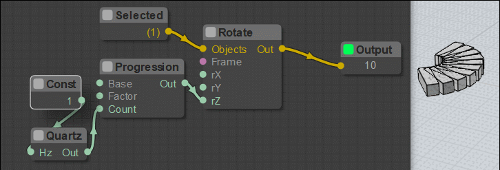

Sorry my speed example above was not very raffined! :)
This other one following not many more but for explain the concept that is very sufficient!
Something like that...draw anything (here a simple box) out of the origin for avoid to manage the center et voilĂ  :)
I don't want imagine that is possible to do! :D
Really funny and very speedy to do! Beauty of the simplicity! Small is beautiful ! :)

Can you validate the process for make such sort of thing! http://moiscript.weebly.com/uploads/3/9/3/8/3938813/easy.nod
Progression seems also indispensable for integrate some numerous data for create some sequential profils etc...if you don't want drawing first outof the Node then Select them...but maybe you have anothers strategy ?
As I use only "Native nodes" for the moment there is no "Scale" directly for the objects! (for the points yes if am i right)
Another thing : does it normal that the "Save" of the "Nodes" don't save the objects selected ?

Some headaches but i find something for have the Twist axis dependant, semi dependant of any transformation! :)
Maybe i re-invent the wheel but...as i am very new on this sport ...that is making a good training for me! :)
As Twist is some time consuming (no real time) so no Quartz for this time! :)
