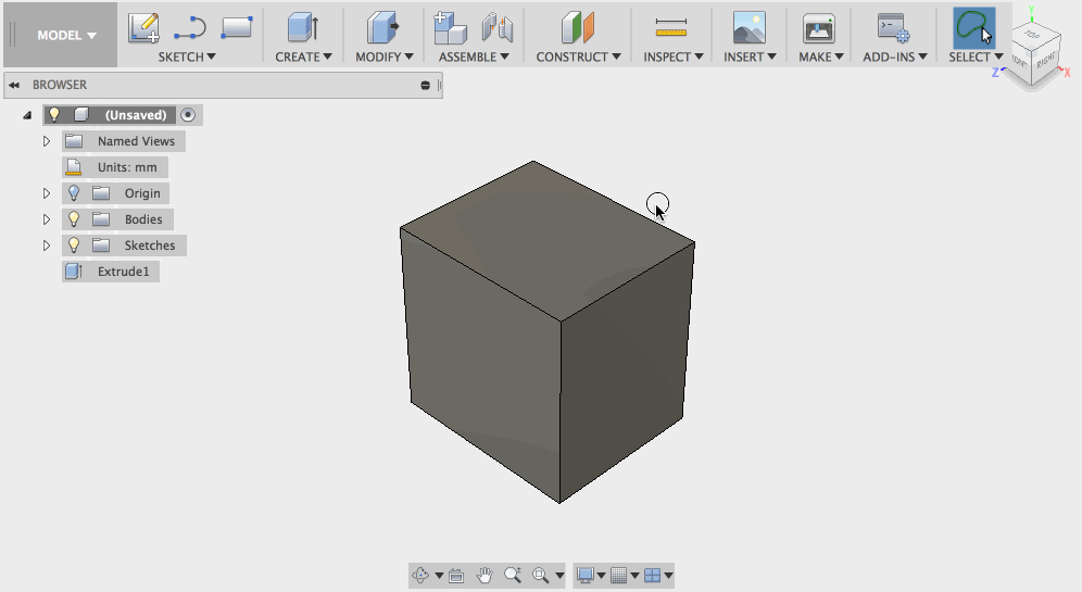

 From:  klaudio
6925.166
Hi,
One suggestion but also curios if it's already possible somehow or there is some script out there.
Option to directly select faces, edges or points and move/rotate/scale them. Something like this > http://www.autodesk.com/products/fusion-360/blog/wp-content/uploads/2017/01/move-face_direct.gif
I know currently you can move things a bit by showing the points together with using ShrinkTrimmedSrf and to some degree, kind of, using Extrude....but all of those are a more like a workaround rather then actual solution, if you know what i mean.
The Fusion360 example posted above seems to work exactly like with polygon where you can select the face and then move/rotate/scale it. Do you thing something similar is already possible in Moi3D, if not then maybe for Moi3D v4?
Thanks!
6925.167 In reply to 6925.165
Hi glmr, I've attached a plug-in which will give you separate X, Y, Z input fields for changing the bounding box center position, like this:
Hopefully that will help with what you are describing. There are instructions for installing a plug-in here.
6925.168 In reply to 6925.166
Hi klaudio, that's something that I would like to add but it's a lot more difficult than what it looks.
It's actually different than with polygons - when you do that in a polygon modeler and rotate the points, the points stay in the same planar shape and the "side walls" of the shape will no longer be vertical after the rotation. The "CAD solid modeling" way is different than that, it rotates the face, then extends the face and extends the "side walls" and intersects those extended pieces with each other so the side walls stay vertical. The points that were rotated are then no longer in the same planar shape as the original, it's elongated by whatever amount is necessary for it to run into the side walls.
This particular kind of extension mechanism is not all that robust in the geometry library that MoI currently uses, one of the things I hope to gain by using a different library would be better handling of these types of operations.
Because it involves a lot of difficult calculations for general cases other than boxes, it's not really something that's feasible to do in a script.
