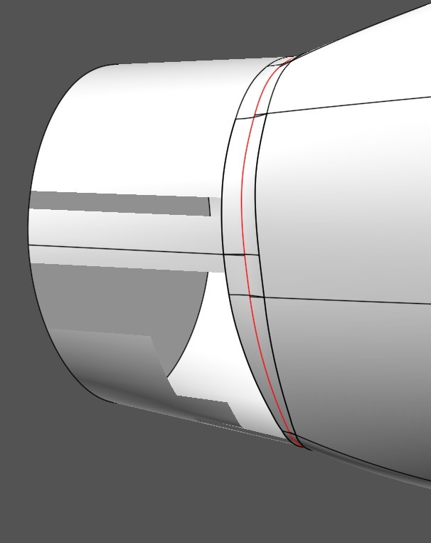

11043.32
I have something with the file just above :)
Scale 1000 Fillet 1000 but little glitch of display ;)
Solid++ works
Acis fails
