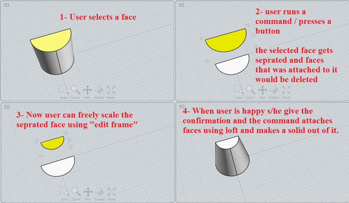

I know it works with one face! Is it possible to make it work on a face of an object? like the way I showed?

I just wish it was doable by two moves!
1- selecting the desired face!
2- scaling it!
Dear Michael I got you! the fact is I had worked with polygonal modeling programs in the past (mainly Blender) and I only did have access to Trial versions of Moi3D, fortunately this has changed!and by the beginning of the new year I laid my hands on Moi3D ( a super cool way to start a new year :-) ) so, I think you would see me more often here! with questions about features that I am more familiar with (considering my history with blender) !

Hi Psygorn,
> 2- scaling it!
Sorry but that's just not how things work with NURBS modeling. If you know you want to make a shape that's scaled on one end like that it's better to just directly construct it that way instead of building something else and trying to squish it.
NURBS solids do not squish around in the same way as polygon modeling does except in some special cases.

Yes Dear Michael :-) I understand that things work differently in NURBS modeling.
Is it possible to make a command or button that helps you to achieve what I mentioned? for example imagine you select a face of a cube u run that command then it separates the face, give you the ability to scale it and then makes it joined to other edges using loft order and gives you one single piece?

Hi Psygorn,
Well it could be possible but it would only work for special cases as well.
For example this object:
Would generate this result:
So that could be pretty weird.
It's better to construct your scaled object from the start.
