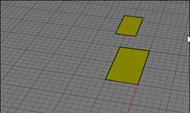

10023.22 In reply to 10023.21
I will remake the bottom left figure! (with the Blend function)
That was easy with the Moi 1.0 :)
Now you said that we can do the same with the Adjust Blend Parameters of the Beta V4 but How ? :)
Seems I have one success by hasard but losted the process!
10023.23 In reply to 10023.22
Just click on one of the edges you are blending between before you exit the Blend command. That will flip the edge direction that is being used for the blend construction.
That is set up so if the automatic twist reduction fails for some reason there is a way for you to correct it manually.
10023.24 In reply to 10023.23
Sorry when i click again on one edge before valid the Blend command
my surface disapears and calcul failled!
I must miss something! :)
10023.25
Edit :) I must use the Add Sync Points!
But drawing on a same vertical! (And not on the vertical middle of the edges or vertical extremities! )
Validate (Enter or Right Click but not Done) then click click on the Edge... for cross uncross!
All that was not so evident! :)
EDITED: 7 Nov 2020 by PILOU
10023.26 In reply to 10023.25
Limited results here with parallel shelves.
Try rotating one of your shelf planes on an axis passing through its blending edge, before the blend.
No sync points.
Or rotate one shelf about its center... So the blending edges are not parallel, nor parallel in top view...
EDITED: 7 Nov 2020 by BEMFARMER
10023.27
@ Bemfarmer ...you right that is infinite crossing with rotating the planes! :)
Else funny Blending!
Result is a solid after Join
The Big "blended corner" is just increasing the Bulge out of reasonable limit! :)
10023.28 In reply to 10023.24
Hi Pilou, so it looks like in the particular symmetrical case you have there, the self-intersection in the twisted version confuses the blend construction mechanism.
If you move one of your planes a little bit then you should be able to click on an edge and make the twisted version.
10023.29 In reply to 10023.28
So a little bug! ;)
Else effectly works if move or rotate :)
