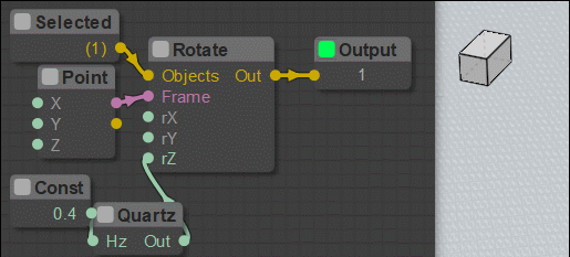

Can you validate the process for make such sort of thing! http://moiscript.weebly.com/uploads/3/9/3/8/3938813/easy.nod
Progression seems also indispensable for integrate some numerous data for create some sequential profils etc...if you don't want drawing first outof the Node then Select them...but maybe you have anothers strategy ?
As I use only "Native nodes" for the moment there is no "Scale" directly for the objects! (for the points yes if am i right)
Another thing : does it normal that the "Save" of the "Nodes" don't save the objects selected ?

Maybe a last difficulty will be to find a variating axes changing inside the object at each step for thing like twist, rotation etc ...
26 Sep 2019   [#229]
Some headaches but i find something for have the Twist axis dependant, semi dependant of any transformation! :)

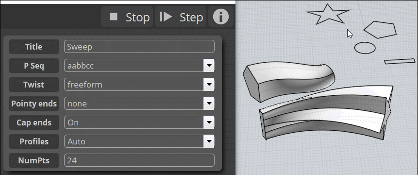

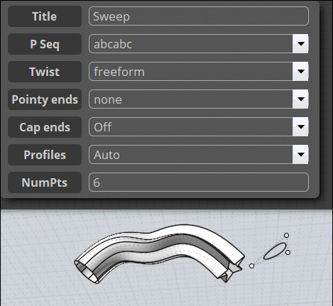

Node Sweep
First perplexity who is double!
What is sequence P abcabc - aabbcc ?
What is the last line NumPts? Seems there are not the Numbers of Profils' Pts (become 3 for the "star") seems not the number of sections --- ???
Edit: a miracle! - there is a documentation for the Extention Sweep node inside the extensions file !!!
So seems my 2 questions are resolved! :)

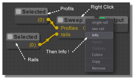

2 Oct 2019   [#233]
Even better the Info is inside the Node Sweep itself by Right Click on the Node!
(I am affraid that is not the same for the other extension Nodes! There is the Info but it's empty for the other nodes! ;)
Clicking Info open this on the Node Editor!
Sorry for the Subliminal Asus publicity! :D

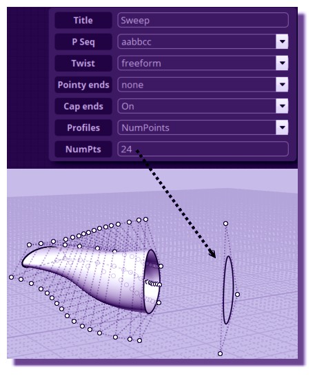

2 Oct 2019   [#237]

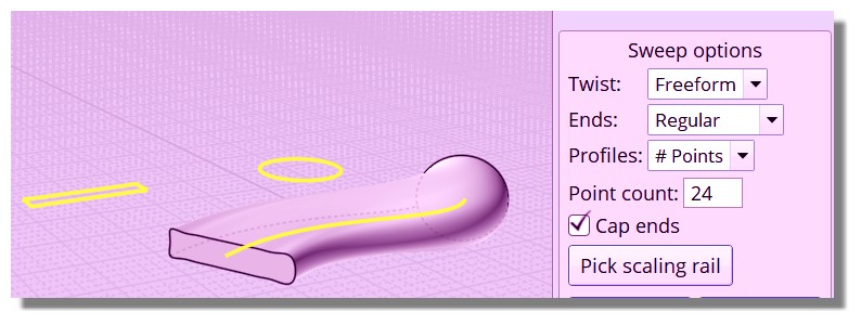

I see only 3 points against 24 asked! :)
But maybe it's not possible to see them ...maybe used only for calculate ???
And funny that a circle will be not more a circle at the "end" of the sweep with number of pts like 24...

Just a rectangle and a circle...one curve rail...
this internal cooking of number of pts is not very important for the moment...
it was just for try to understand in deepth
<< the "# Points" mode is another style of rebuilding that samples a uniform number of points along the curve for the reconstructed curves. You can choose how many points are used.
<< This mode results in very smooth output, but small details in the profiles tend to be lost.
I understand that and funny to see a rectangle becomes a section of a wing's plane! :)

Hi Pilou, testing with the regular Sweep command if you do a one rail sweep from a circle to a rectangle and set the "Profile: # Points" option, the number of points entered in does have an effect.
If it's not doing it with the Node editor possibly there is a bug in the node editor sweep handling somewhere.

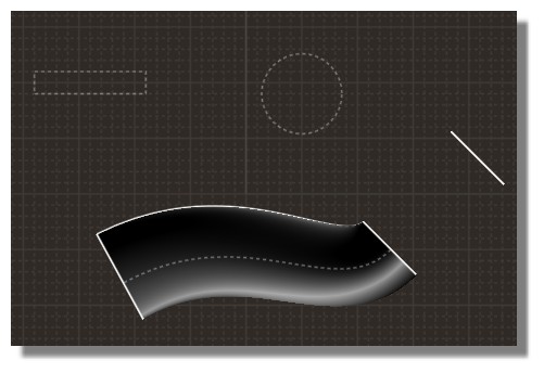

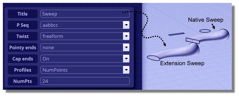

Indeed it's not exactly the same! (with of course the same rectangle, circle & curve rail & Number points)
Here the native Sweep...so there is a glitch somewhere or the result wanted in the extension will be an other thing...
Rectangles and circles are very not the same! :)

EXT: Construct2/Sweep2 works similarly to native Sweep with "Profiles" option set to "Auto" or "Refit".
However, it is necessary to move profiles away from rail curve. See below, profiles positioned at X:999* Y:0 Z:0.
If "Profiles" option set to "NumPoints" it will rebuild Nurbs as defined by the number input (12 is default)
Does this help?
James

2 Oct 2019   [#243] In reply to [#242]
Yes that works for the normal options but not for the last "number point" option! ;)
I remade your example that is falling again like above!

>> Yes that works for the normal options but not for the "number point" option! ;) <<
I had preempted this query with additional note in previous post. The NumPoints option allows for rebuilding of input curves. In the instance of sweeping from a circle to a rectangle the resulting surface will be a polysurface with multiple seams. If however a single surface is desired it can be achieve by rebuilding the profiles so they have similar control points. Of course unless the number of points is set extremely high the polyline shapes such as the rectangle with lose definition.
If this still not clear perhaps Michael could phrase what I am trying to say more eloquently.
