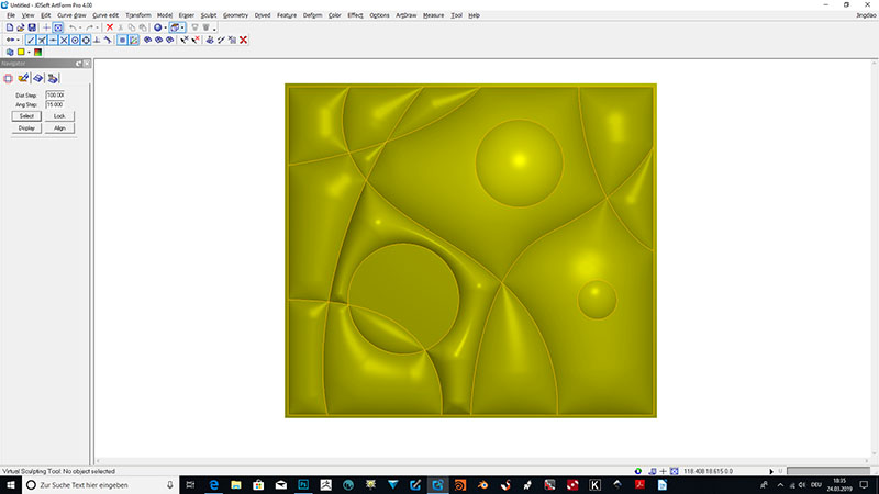

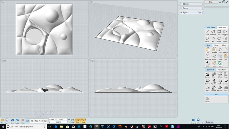

a bit off-topic, but I used your image and re-created it in MoI and then used ArtForm,
which you also have. In ArtForm you can save the model as bitmap and then prepare
the bitmap for ZSurf.
Please note: I did not used any smoothing brushes, only wanted to show you a quick
way with MoI, ArForm and ZSurf.
(With JDPaint one can save this model also as NURBS model … )

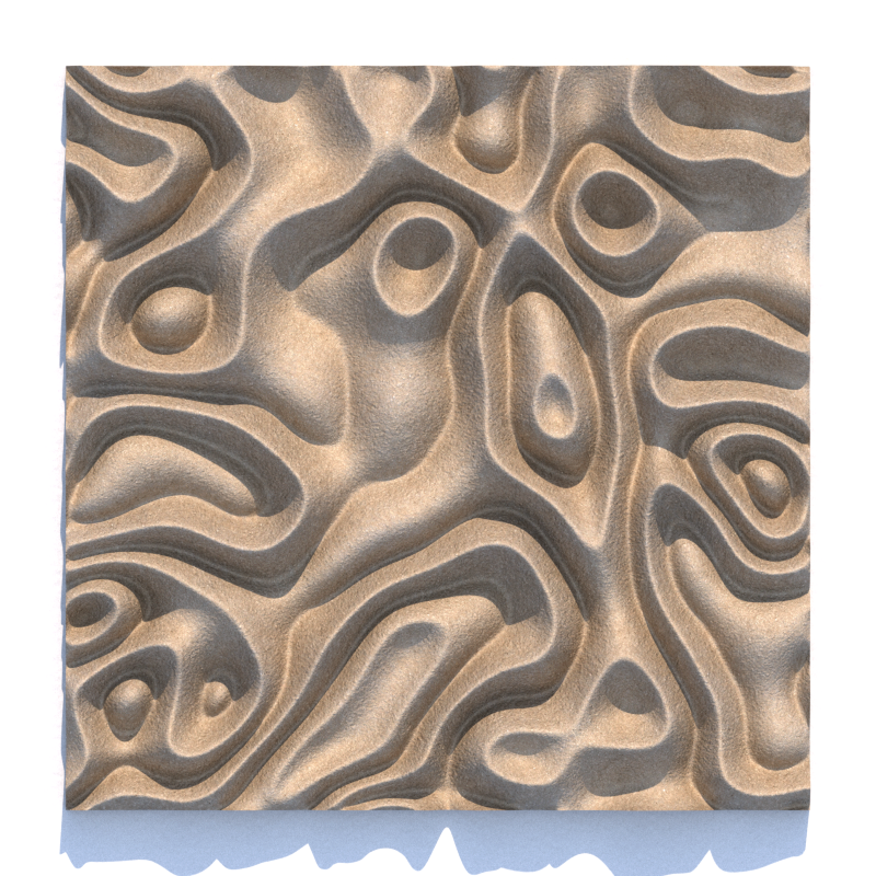

Back on topic … I rendered one more image with a more natural (outside) look
while using a sandstone texture. I think this might be an interesting topic for
ArchViz Designers to create such wall panels with Houdini and MoI. I could
imagine colored, like the first one, for interior design and this one for outside
walls.
