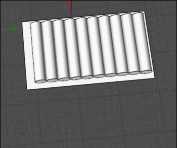

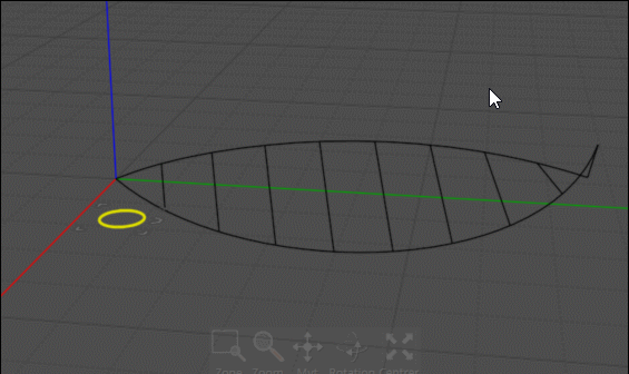

Hi !
I was looking for a way to cause a parallel displacement of a body.
Didn't want to redraw the thing just because the angles had changed.
It is the side of a theatre chair, the inclination of the floor has been changed.
At first I only tried to move the points of the face, at least it works and you are very flexible.
Then played around with "Flow", and it also worked with "Projection".
After "cut and connect" the two results to get the armrest horizontal again.
A very interesting story, this Moi 3d!
Hope the tips and tricks don't fall asleep, I'm an interested student of this post!
Franz
