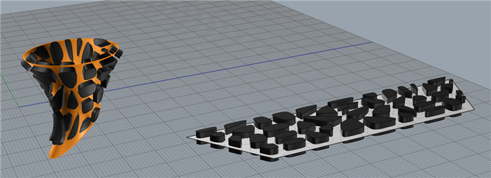

By "Messy" I meant Below:
The Voronoi cells look more distorted! and it seems they are wrapped around a symmetrical surface (Like a funnel). Note: My target surface is not symmetrical!
And if you saw below link:
Edit: http://moi3d.com/forum/messages.php?webtag=MOI&msg=10315.1
Zooen has created an amazing vase!
I wanted to replicate upper part of his/her vase! I feel like my file does not look anything like that! Maybe I am wrong! but this is what I feel!

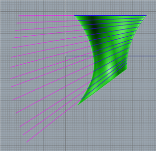

As Michael said, if you want to flow without this problems you have to reconstruct this part with a loft or sweep method.
My proposition, but I'm not sure this is the more orthodoxe one, is to follow this process :
- drawing some horizontal lines (use array or do it one by one)
- project these lines on you object
- select the object
- (Construct / Curve / Project)
- select the lines
- with the curves you did plus the top and bottom edges of your object, you can do your loft.
I added left the superposition of original and rebuild surfaces to see if this is correct. It seems good.

14 May 2021   [#62]
Seems i have a not so bad result only with the Flow function!
Just place the Start trapezoïdal surface in the middle of the Vornonoi piece! ;)

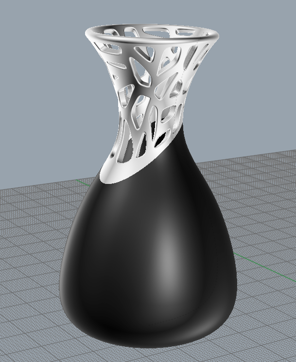

Hi PILOU, I did not mean it is bad! Maybe I should say it feels different! (Please take a look at Zooen's work! (Ears of Wheat here: http://moi3d.com/forum/messages.php?webtag=MOI&msg=10315.1)
I wanted to replicate the vase!
15 May 2021   [#66] In reply to [#65]
Vase is inverse than that ;)
Empty parts are full and vis versa ;)

I don't know how Zooen done it, but this method is a possibility...

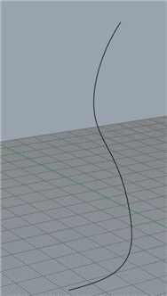

I drew a profil for the vase.
Made the vase by rotation (no cap)
I the vase cut to have something like you had (the top part)
With the same process seen before, I did a loft object with multiple curves (here in green)
I flow a Voronoi set of objects on this lofted object.
I use the vase (total vase, so perhaps have you to redo it because it has been cut before) with a Offset /Shell to have a volume
Next I use the new voronoi set in a boolean operation (difference) to make the holes.
I finished with some softerizer actions, fileting the holes and blending the top to have soft border .
Not so far from Zooen result.
Zooen's version is a slim vase, mine is a fat version.

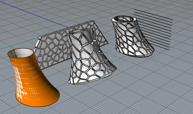

15 May 2021   [#68]
Another method :)
Voronoi
Flat Lines
I just project the Voronoi...from Side View
Make a trim (manually)
Put a Shell
(if you kill the cap you have a vase! :)
et voilà :)
15 May 2021   [#69]
If you want like a true vase :) A little trick ;)
Of course you can fillet all internal small pieces "voronoi" (not made here) before projection!
(curious things on the up "golden voronoi" is just reflexion of material! :)
