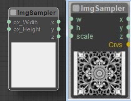

Does the ImageSampler has limitations ?
Format JPG, PNG ...?
Colors, Grey Levels, B&W, ...?
Size x,y ?
Does it possible to put a Version's Number of Extension, or a date...?
Because it's a mess for know what is the last one! :)
in the title for example (Titre = Title Fr / Eng ;)
I don't see PerlinNoise, PerlinNoiseFn ...
http://moi3d.com/forum/index.php?webtag=MOI&msg=9581.105
...in the Updated NodeEditor ?
http://moi3d.com/forum/index.php?webtag=MOI&msg=9358.1

The ImgSampler is limited by the processing time and memory it takes to make really large images.
It works with JPG, BMP, PNG, GIF and possibly other formats not tested.
All image colors are converted to grayscale during the processing. Size capacity was not tested. It is capable of very large renderings and will take time and memory to process them.
The latest version has the Crvs output and the image size below. Version numbering would be a good idea because of all the update improvements and more in the future.
PerlinNoiseFn is the function library for PerlinNoise. It does not show in the menu.
Wayne
