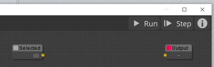

Does it possible to have some nodes by default on the screen at start of Elephant like the Output ?
7777.1613 In reply to 7777.1612
For function loadDefaultNodes(), see lines 21 through 26 of the file init.js, located in core subdirectory of nodeeditor.
var node_output = LiteGraph.createNode("Basic/Output");
node_output.pos = [800,100];
graph.add(node_output);
7777.1614 In reply to 7777.1613
Many thanks!
Cool : works like a charm! Will added in few times http://moiscript.weebly.com/node.html#addanodeselected
var node_selected = LiteGraph.createNode("Objects/Selected");
node_selected.pos = [400,100];
graph.add(node_selected);
EDITED: 6 Oct 2019 by PILOU
