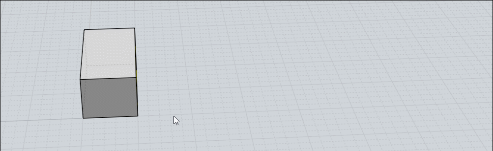

18 Feb 2020   [#13]
Just for the fun : use the SsPlit function for speed modeling! :) (P = Ssplit)
The first time click an edge - Mirror enabled
Move & Create 2 lines on the volume
Click an edge
Right Click for recall the Ssplit function
Click an edge
etc...
then extrude Positive or Negative faces
and as always it's difficult to select "tiny faces" - Select a Big face then Little face(s)
then re-click the Big face for deselect it! ;)
and extrude them
etc...

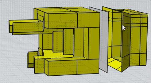

18 Feb 2020   [#14]
As volume is now complex Subdivide can't work easilly on all the volume!
So volume must be trimed in some parts for have have some partial subdivisions
Use of the Bridge function for transition between a curvature perimeter and a straight perimeter
so a perfect solid at the end!
With some Insets & Shells
