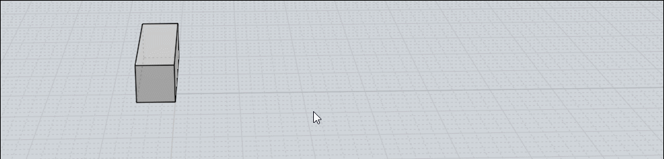

10 Mar 2020   [#46] In reply to [#45]
Oh no! You have the magic function Ssplit with selection of one(s) face(s) (your image above)
Of course make a shortcut for a speedy race ;)
mine are P = SsPlit, E = Extrude, K = Subdivide, S = Sscale , B = Bridge
With only that you can make miracles! :) (I can't memorize more! :)
Here only 2 faces in the same time!
Like here all faces are splitted in the same time!
But you must select one face first then all the rest with for example the rectangle selection!
By hands will be a nightmare : drawings lines, Triming, etc...
or only one edge for "SPlit" all the volume!
Here split edge one by one (very cool to make a right Click for recall the function after a new edge selection! ;)

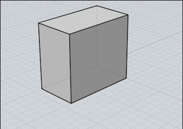

12 Mar 2020   [#54] In reply to [#53]
In fact that is very simple! :)
The volume must be without internal faces!!!
This follow is the general case who always works! The Bridge function between 2 separated faces!
In this specific case the Extrude will also works because faces are not on the "extremities"
and not touch between them !
Box on the left don't work because Top/ Bottom face are too complex for the Plugin!
You must split it first! With any method but without internal faces! Here there is a new building :)
Use of the SsPlit function is of course used!
Here following Subdivision after Extrude will not work!
Because there are no more "triming faces"!

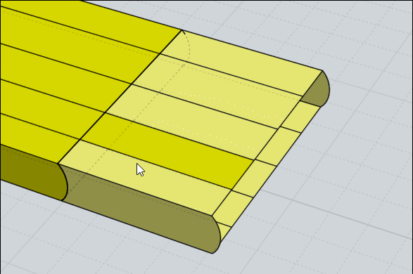

12 Mar 2020   [#56]
In case of 2 neighbour (or more) different faces - Will works with the volume's faces extremities! ;)
A possible method (the funny game is to find the more speedy effective one! ;)
- Select & Copy Move the 2 faces
- Delete original (easy because yet selected)
- Select Perimeter (careful to not select the vertical middle edge(s) !!! )
- Extrude WITHOUT Cap Ends!!!
- Join All
- SubDivide
Of course can be multiple if you take the same length of Extrude! ;)
(there is an optic effect of record, extrude goes from faces to piece as post above)
