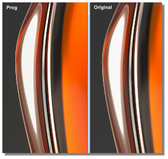

Maybe you can try this free one for unjaggies your big format. even *4 size if needing... https://deep-image.ai
Ps Your original image is too large for be loaded in the prog...so half it then size*2 or more in the prog... ;)
Speedy test with your bootle half size (then size *2 + strong unjagg both in the prog) result is done in PNG as given in png
From: Finema
21 Feb 2020   [#22] In reply to [#21]
Frenchy, it's a screen :)
the 3D model is very smooth
