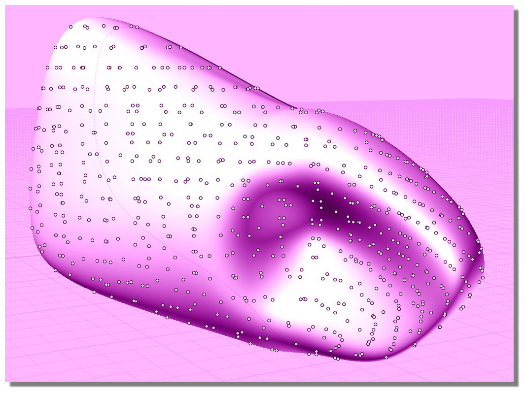

Which nodes is for distributing points over surface shape?
29 Oct 2019   [#5] In reply to [#4]
Maybe something like that ?

30 Oct 2019   [#16] In reply to [#15]
With my method above you can have any intersection points with any complex surfaces! ;)
Just take more than my few lines and their only one orientation!
No need complex algorithm :)
No vertical here :) Configurations of the Grid's lines are infinite! (Position, orientation, number, ...)

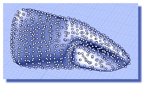

30 Oct 2019   [#17]
@ Michael
Does it possible to see only "visible points" ?(and not in the same times the points who are behind)
For a more conprehensive figure! :)
I can hide them manually but...in case of complex forms that is not so easy to use a selection box! :)

30 Oct 2019   [#19] In reply to [#17]
Sorry no there isn't currently a way to do that. The current point display handling is focused on having a small number of points used as strategic markers to refer to. It's not really designed for handling a whole bunch of them like you show there.
