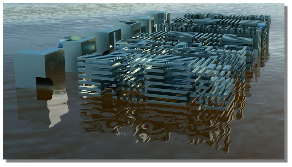

Here's a new NE generated screen transition

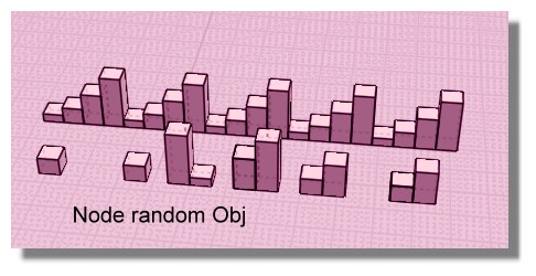

Hello
whith node random_obj i have this
For simulate different gaps: display random number of objects on their positions from a collection
Node random Obj is existing
not yet exactly that i wish :) the gaps 1 3 1 1 1 2 1 result must be on each object
but it's more like that i wish :)
A random gab between each object selected!
Classic Random
Move is existing
Display is existing
Not sure about the "one by one"...and the "loop / return"
Does this is possible ? A sort of random gab distribution between each object selected!
For make some variation of this follow where gabs are regular except on the front corner! ;)
