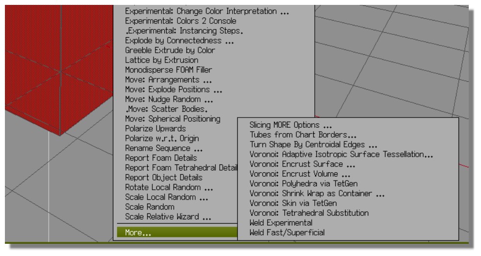

10 Jan 2020   [#190]
Inside free Wings3D also ;)
Special "Manifold" version! (there also many cool functions in these extension !
https://www.dropbox.com/sh/3cwsi5kvm0jeiae/AACWabcUIFe8UObZoyOvSQ6Ca?dl=0
