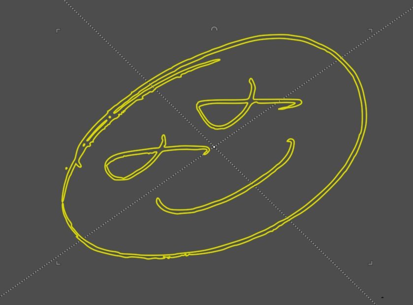

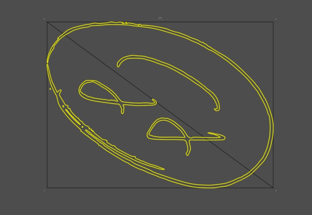

maybe this can help you ? http://moi3d.com/forum/index.php?webtag=MOI&msg=7734.2
Else Bounding Box Center will give you a center of your object
Free to you to draw any line(s) from this point to interesting directions!
And BoundingBox will draw a box around it!
If you draw the diagonal you will have a middle of your object!

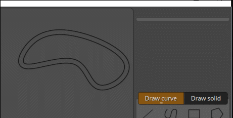

You have flat line who make middle center line! :)
Not exactly that you want but...
Ok CMorph can make that you want! :)

> If I have certain shapes...is there a script or can Moi generate a middle(centerline) from the shape?
Not really from the kind of noisy inputs that you have there.
If you have 2 cleanly drawn curves you can use the morph script that Pilou shows to make an average between them but I don't expect it to work well for your sort of more "data processing" type input.
The overall focus of MOI is on drawing stuff, it is not focused on processing noisy scanned data. It's not the right tool for this particular kind of job.
