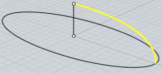

Hi Matadem, one of your curves is a little short, this could be what is causing problems doing a boolean with something created from it:
Also it kind of looks like there may be some duplicated faces in your ellipse solid.
For making a dome the rail revolve command (Construct > Revolve >Rail revolve) can be good for that:
https://moi3d.com/4.0/docs/moi_command_reference7.htm#railrevolve
You set up a side profile curve like this:
Then select the profile, run rail revolve, then at the "Select rail curve" prompt select the ellipse, then pick 2 points for the revolve axis.
I'll see about setting up your file like that shortly.

Hi Matadem, here attached is the set up for your shape using rail revolve.
First select the profile curve:
Run Construct > Revolve > Rail revolve.
The prompt will say "Select rail curve". Select the top ellipse edge:
The next prompts will say "Pick revolve axis start point" and then "Pick revolve axis end point". Pick these 2 points on the center axis line:
A solid dome with the bottom capped will be created and you can boolean union this onto the base extrusion.
