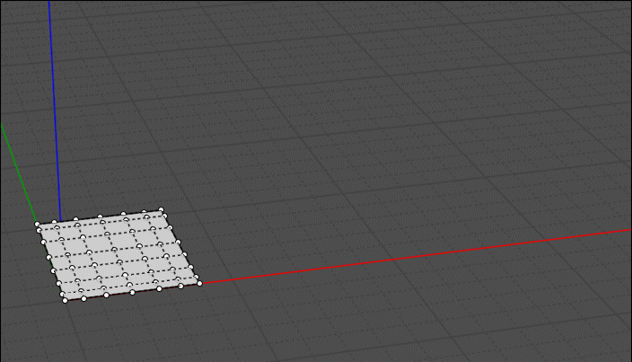

23 May   [#13] In reply to [#1]
"""""""""""""Is it possible to add 'Proportional Editing' for Surface's Control Points like the one in Blender? If so, then organic surface creations / explorations will be greatly improved """"""""""""
For "Exploration", most people are overlooking MoI's "History Enabled" tools.
So you generate your object or surface from Curves. Then "Edit the curves" to get your "Proportional Editing". I can make a video exactly as you show by doing it that way.
It's just not on imported or previously edited object where that initial history is broken. Just for "Exploring"!

24 May   [#18] In reply to [#14]
Here is 1
From: BurrMan
24 May   [#19] In reply to [#18]
Here is another.... I did surface and solid and enabled history in Deform
From: BurrMan
24 May   [#20] In reply to [#19]
And one with a surface that would be dense in points, but getting the "Soft Selection" with history on the creation curves...

25 May   [#25] In reply to [#24]
OP's original image....
