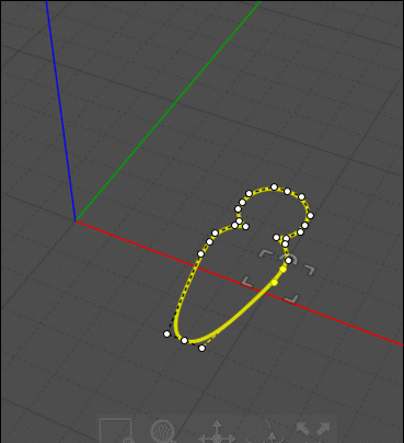

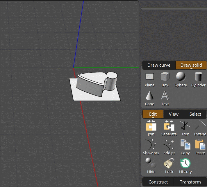

From: BurrMan
24 May   [#18] In reply to [#14]
Here is 1
From: BurrMan
24 May   [#19] In reply to [#18]
Here is another.... I did surface and solid and enabled history in Deform
From: BurrMan
24 May   [#20] In reply to [#19]
And one with a surface that would be dense in points, but getting the "Soft Selection" with history on the creation curves...

25 May   [#23] In reply to [#22]
Seems to me that will be exactly the same! ;)
I deplace only points of a surface ...target object can be any thing... a surface, a volume etc..
The secret is to select target result, call Histo and move Points ! And this at any time of the session!
(if target object not modified of course)
here a thick surface! :)

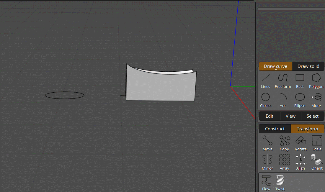

From: BurrMan
25 May   [#28] In reply to [#26]
“””””” However, I didn’t quite understand the third one””””””
The first 2 showed “if you were the creator” and keeping your curves to use with history (5 point curve for 500 point surface) you can get creative to “kindof” get what you want by moving a mass of points smoothy with just 1 pick point.
The 3rd one was me thinking “how do i apply it if YOU send me a surface with 500 points and NO CURVES.
So the 3rd vid is showing using flow and using a DUPLICATE of the mass point surface. In theory to get the “less points” to use.
But as an afterthought, i would still need to build a surface to gain access. I would probably attempt this with iso curves on the surface then rebuilding the curves to get simple curves to use. (If i could do that, that would eliminate FLOW!!)
So you got something out of it! We (and others) can explore more this for “scenarios” to see if its actually viable or false. Certainly not a replacement for poly soft selection but maybe a good lick in the toolbag?
Let me know…

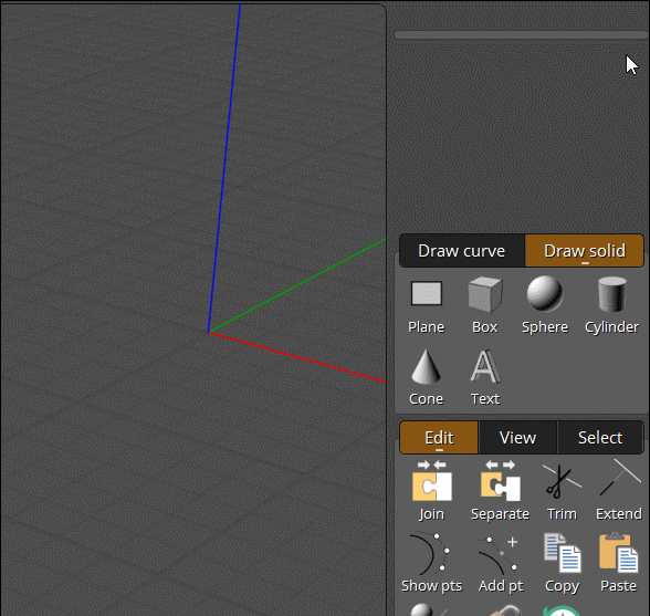

27 May   [#33] In reply to [#32]
Where are you stuck in the Burman videos ?
First is just move the Control points of the curves!
Don't kill the original curve when you have made a function! (here an extrusion)
About the Flow Function! You can take any volumes, surface etc...
Copy the "start" under surface
The littel trick is to select the object result then call the History! ;) Not intuitive but that works fine!
You can add points on the surface target before the Flow but object will be deformed...
(don't kill or modify the original Object and surface)
No more simple and speedy! (and i have an more 12 years old latop! ;)

30 May   [#35] In reply to [#34]
The secret! ;)
You can't add points to several surfaces in the same time!
So you must copy one surface with its adding points made! As shown in my previous video! :)
Else for general case for deform a complex volume...by face...don't move the perimeter's points !
For the complex volume above the rectangular surface it's just the Flow function! :)
http://moi3d.com/4.0/docs/moi_command_reference8.htm#flow
You can take any surface as start base! Planar or not!
so a rectangular, circular as a disc, a bump etc...
Better if you take something like your base object! Take the copy of the bottom object can be also cool!
