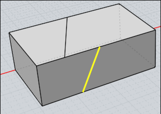

What speedy method(s) can be used for make the same in Moi3D ?
On 5 sides (side bottom is not necessary) and same unity on each sides (say 1 )
Grooves on lines (or faces) selected... function Inset don't give exactly the same result...
but surrerely can be used for some steps...
Ideal will be draw lines then Gooves are made ! :)
Of course for some lines in the same time because one by one is some painful ;)

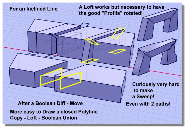

Some beginning ideas.. but here only one line! :)
(not moved of 1 for more visible groove)
Boolean Diff, Offset, PolyLines, Extrude, Boolean Union

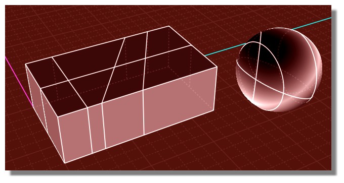

9945.3 In reply to 9945.2
Yes for any volumes : cubic for a first time or not second time ! :)
Inset function is quasi perfect except the angle side! :)
Seems make a "cubic" wire then a Boolean Diff makes maybe the trick !

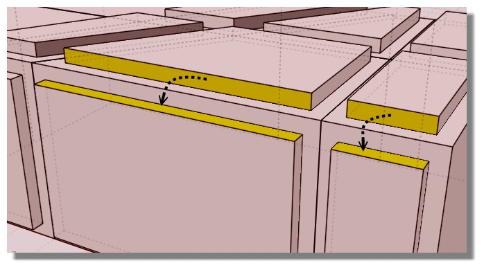

After a boolean cutting, inset is not a so bad idea.
You could "inset" two or three faces of a solid together to avoid part of the corner problem you had.
For external corner you select together 3 faces, for external egdes, 2 faces and top internal face only one.
Perhaps another way is
-- Copy/paste original solid
-- a boolean cutting with lines
-- explodemove function on cutted solids
-- your copy is inner solid and have to be resized
The problem is : with ExplodeMove you don't have spaces not so regular.

9945.6 In reply to 9945.5
Very cool variations!
The ExplodeMove was a very tricky try! (maybe also with Scale and/or Orient / Line Line )
Here ExplodeMove + Scale with your trick of second copy Volume! :)
Render : Free CADRays + Old Free Fotor
All funny of that is that made in a half minute! :)
Curious : Vertical Fatlines inclined (or not) must be rotated!
EDITED: 13 Sep 2020 by PILOU
