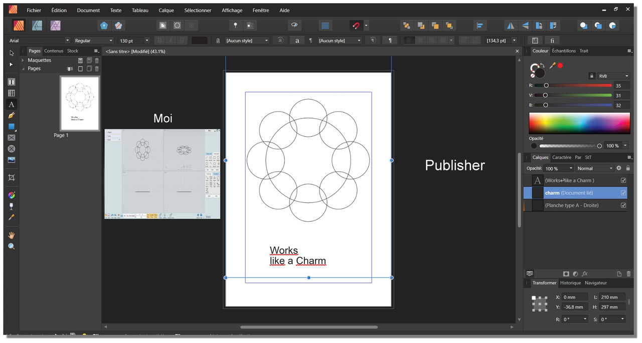

Absolutly no problem with the triology Affinity (Photo, Designer, Publisher)
And the price is some attractive during the covid Period ! (27€99 each for life ! )
(10€ 99 for Ipad for Photo & Designer)
Moi PDF (vector) works like a charm in the 2 ways! ;)
