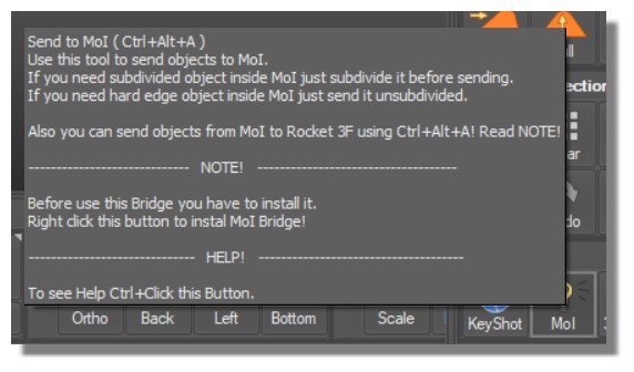

About the free or pro Rocket 3F you can Copy Past an objects selection between Moi & Rocket in the 2 ways
So a transformation Nurbs to Polygons or the inverse ;)
EDITED: 7 Apr 2020 by PILOU
9757.3
With the last Bridges all works like a charm!
Just Press Ctrl + ALT + A when you are in MOI
Just press the Moi Button when you are in Rocket 3F!
