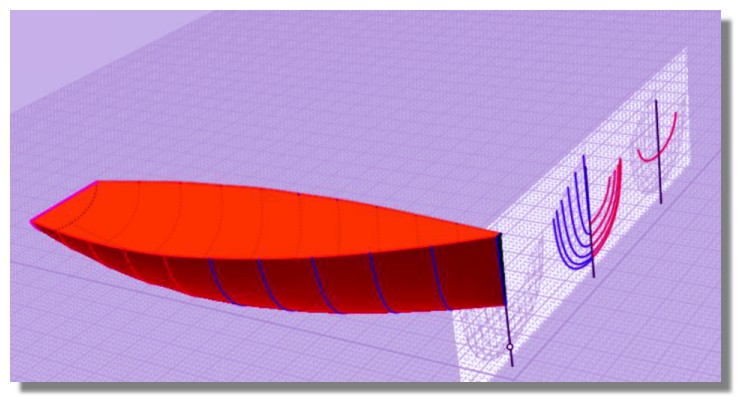

Sorry a video in French but very visual ;)
Very classic drawings for hulls with a little plugin : can be helping ;)
http://moiscript.weebly.com/deacuteplacer-des-objets.html
The plugin must placed inside folder commands
Make a shortcut or press Tab and write MoveSliceToPoint (with any capitals but whithout space)
MoveSliceToPoint : http://moi3d.com/forum/get_attachment.php?webtag=MOI&hash=73d256cf1cf996eff7bf94cac88415e8&filename=MoveSliceToPoint.js
EDITED: 23 Mar 2020 by PILOU
