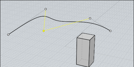

Is there a tripod to use to constrain movements to one axis?
Something similar to rhino gumball?
Thanks a lot

9721.5 In reply to 9721.1
Hi Marco, yes make sure you have "Striaght snap" enabled on the bottom toolbar to get movement along one axis.
Then if you move you mouse close to the axis it will snap on to it. You can also hold down Shift to make it engage as well.
