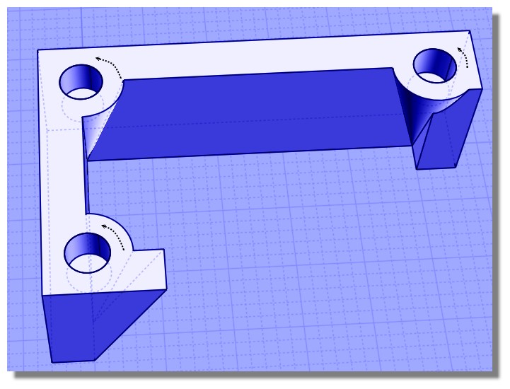

I am hoping someone can help identify what is causing the display glitch after a boolean.
9674.2
Don't know why but our inventor Michael will find it...
If you rotate your cylinder (the lower one), the problem is out.
I think it's a alignment problem.

Perhaps a problem with these egdes ???

9674.4 In reply to 9674.2
Ah - I always forget about seams. Thank you for the reminder.
 From:  nameless
9674.5
There is a handy merge command that is useful for joining edges that are already part of a solid object. Sometimes this simplifies things, so worth checking out.

9674.7 In reply to 9674.1
Hi Charlie, it seems to be a glitch in the display mesher on the top face. Your actual model seems to be ok, if you go to export it out it should export ok the bug looks to be only in the display of it.
I'll put it on my list to investigate to see if I can improve the display for this case.
9674.8
Just rotate all the cylinders for "unaxe" the curve generator before the boolean Diff and all will works fine! ;)
I have remarked that many many times!
