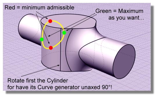

9662.7 In reply to 9662.3
And like this :Variable fillets ...so you can put any number of Points and Values! (admissible of course)
Here Red = 1 Green = 3 ... if you have very few place Red = 0.0001 and Green = 3 ;)
Axed generator curve can generally makes problems in Fillets when it is on the same way than fillets's paths!
Else Variable fillets are beautiful simplicity!
