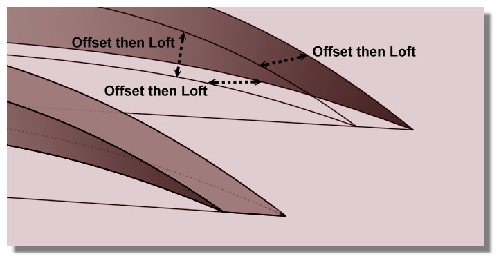

9637.2 In reply to 9637.1
Maybe like this...(Trim the extremities of the Offsets)
