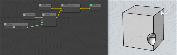

I know that I'm probably asking a little too much with this question... but is there a script or a feature that allows a "Live Boolean" type feature, whereby the user can perform a Boolean Difference and be able to see the result live whilst moving the cutting object?
I vaguely remember seeing something in the node editor script, but have been unsuccessful in finding any further info.

Yes you can make Live Boolean with Elephant...
but you must make the Nodes working between them! :) And that is not evident! :)
you script first and not modeling! :D
A very rustic speedy one!
The curious move of my cursor is due to my Screen reccorder! :sweat_smile:
If i relase it over the screen of Node Editor it goes to 0 start's Slider !
So I must use it out of the node editor! :)

 From:  Whiteman Dynamic (TIM_WHITEMAN)
9612.3 In reply to 9612.2
Merci beaucoup Pilou, je suis très reconnaissant!
That looks like an impressive solution and I am keen to try it out!
I like your cursor! lol It has a mind its own! :D
Thanks again for your kind help and advice, I always find this community so helpful and friendly.

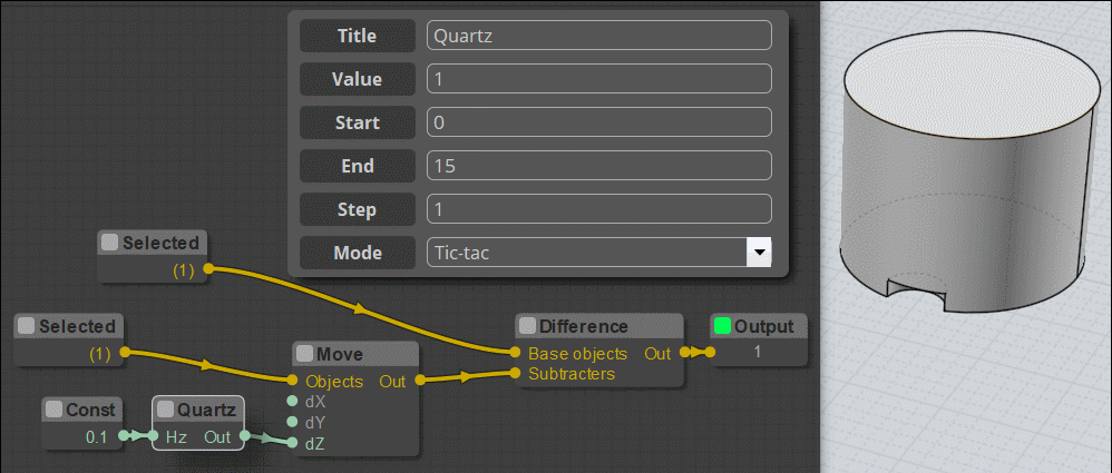

9612.4 In reply to 9612.2
Pilou -
Use Quartz Tic-Toc to move the selected object. This method has me thinking of other uses.
Thank you,
Wayne
9612.5 In reply to 9612.4
Indeed that can be made! :)
