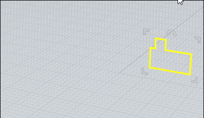

9574.6 In reply to 9574.5

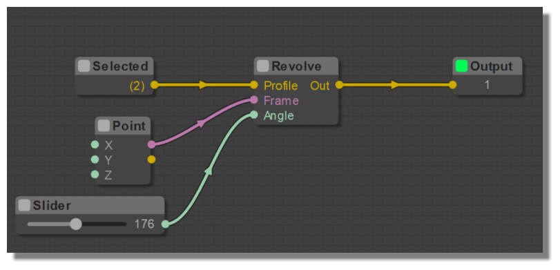

Just use Elephant! ;) Thx to Max Smirnov!
English/French http://moiscript.weebly.com/biblio-elephant.html (for install, manual etc...by me )
Nothing difficult...it's the Revolve native function emulated!
I will make it as soon I have taken my diner! :)
So wait a little :)
So something like that...
Frame is the vertical axe X, Y, Z give of course values or 0,0,0 by default
Slider goes 0 to 360 with zero decimal so integer degre - Slider can have a Mini Maxi (you can all regulate)
At the end you obtain a Moi object absolutly normal! :)
this node following that you can reload! ;) http://moiscript.weebly.com/uploads/3/9/3/8/3938813/revolve_emulated.nod

9574.8 In reply to 9574.6
Anybody to give me some quick direction here. I just went to rebuild this nod that frenchy shows (Revolve emulated).
I couldn't find how to add the "Output" node. I think I right clicked and went through all the options, but I could have missed it.
I can load the node frenchy links to and it works fine. Maybe I don't have a full node editor install? I haven't been following it well.
[EDIT] Found it. My NodeEditor window was sized down a bit, and the "Output" node, which is the upon start ofg a new project, was sitting, hidden off to the side. [EDIT]
Thanks again.
