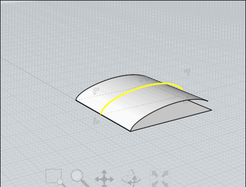

9561.6 In reply to 9561.5
You want something like this ?
All seems works as wanted...
Page follows exactly the curve! So anywhere you want and with any followings...

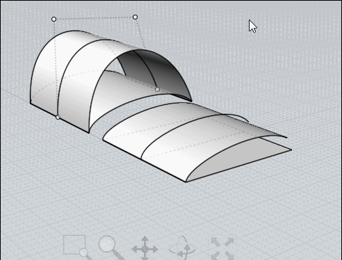

9561.7 In reply to 9561.6
Yes exactly, and I'm able to do that if i will open the file and do exactly like you did. BUT when lets say i will undo the action - for some reasons. I wil get this.
and after that I will get the same weird result. Its like Moi lost a first vertex and now its opposite.
Try to undo the action. and check it. also i think that copy and paste could have something with it. Instead of duplicating try to copy and paste and bug should appear
So I'm doing exactly the same thing and we have a different results.
9561.8 In reply to 9561.7
Sorry I can make any number of undo and all works fine!
I believe that if you click on the near left extremities of the 2 curves (Base & Target) you will obtain the good result! ;)
Sensitive place's click as said previouly!
