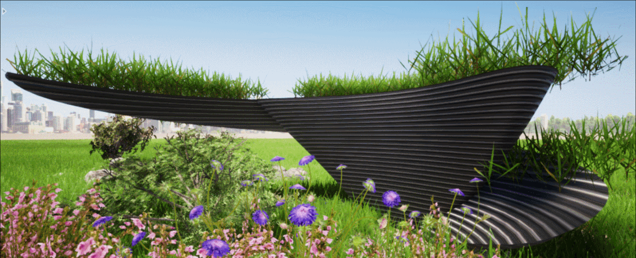

For a more elaborated exterior aspect + materials, wind, vegetation, ocean, seasons etc...but not more for the basic animation (Only along a path)
try the free TwinMotion! I hope that you can load it because November is the dead line but i don't now if it's start or begin month!
https://www.unrealengine.com/en-US/twinmotion
With moi objects
