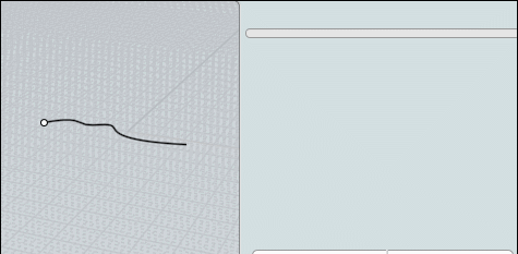

Hi propmaster, there is a plug-in here that will show the length of the current curve that is being drawn:
http://moi3d.com/forum/index.php?webtag=MOI&msg=2703.12
If you want to enter in a length you could do that by formula. Check out here:
http://moi3d.com/forum/index.php?webtag=MOI&msg=2558.2

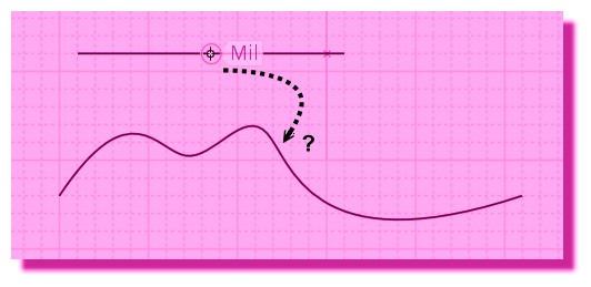

In the same order of idea...not possible to have this helper Middle?
(sorry i have used the French version! :)
9544.7 In reply to 9544.6
It could be possible to make that work but what would be the benefit? Why would you want to snap at that location on the curve you show there?
9544.8 In reply to 9544.7
I had the case where i must draw something (another curves or anything else) between the middle of 2 similar curves or not for make some exotic chercherboards on surfaces where angles were different than the Iso curves!
Not vital but practical...I can of course use Transform Array/ Curve with 3 Points ;) but...
9544.9 In reply to 9544.8
Hi Pilou, right - if you do need that particular point for some reason Transform > Array > Curve can place a point there for you.
Since it is so rarely needed there is not really any benefit for having it as part of the default snaps. In fact it is bad to have a lot of snaps showing that are only useful in extremely rare circumstances. Each snap added can make it a little harder to access other ones.
9544.10 In reply to 9544.9
Yes and surelly takes more time for calculate them...so i will use my little trick for critical things! ;)
