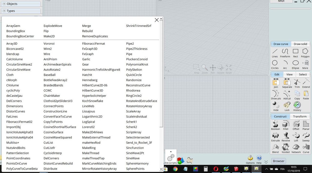

What is this UI ?
9535.1
I don't remember how to make this !

That is Scripts.menu.htm or ScriptsFull...
Part of Max's customui.
Mine is located in %AppData% with extra _commands in parallel folder "commands", so that when a new MoI or beta is installed,
the _extra scripts do not need to be added again to stock MoI scripts.

The icon is two gears.
9535.5 In reply to 9535.4
Yes i have it on the V3 and works fine (but don't find the folder / files where is this icon 2 Gears)
And for the V4 all seems at the good place ( -80 Extscripts.html, 81 ExtScriptFull. html etc...) on the Appdata but nothing on the Bottom Bar for launch it! (but don't find the folder / files where is this icon 2 Gears)
I have the Custom Scripts who works fine also with 2 Gears on the Bottom Bar

Hi Pilou, if I remember right the icons for CustomUI are embedded in the .js files as base64 encoded data.
9535.7 In reply to 9535.5
Also for setting it up on v4 there is a different version of CustomUI, make sure you have the right one:
http://moi3d.com/forum/index.php?webtag=MOI&msg=6507.1
9535.8 In reply to 9535.5
For installation it goes like this - unzip C:\scripts\CustomUI.2.0.beta2.zip and you have 3 folders: "customui", "objects", and "startup".
These need to be copied over into the MoI appdata folder, which you can go to by typing in %appdata%\moi in at the windows start menu.
So you should have %appdata%\moi\customui , %appdata%\moi\objects, and %appdata%\moi\startup . The "startup" folder will be there already, copy the contents of the customui startup folder into the existing one. The other 2 ones will be new folders that you will add.

Ok that works : I have now 40 icons on the Bar tool! :)

Ok I re follow the Wayne Install ...so now all is ok! So all compatible!
I have the 3 Icons Buttons Scripts (2 gears) + Windows with all text functions, the Lighting (bulb) and the Custom Scripts (2 gears) with colored icons...
so sufficient for me! :)
