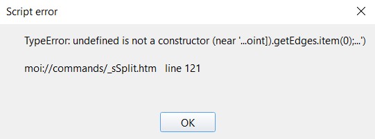

Glitch on the sSplit ?
9529.1
In Beta V4 Not use it for a while but ...
it's insert on a face or Split on an Edge : works fine on an Edge but not on a face!
here on the V3
Here the error message on the last Beta V4 on a face! (same on previous beta V 4) :(
EDITED: 12 Oct 2019 by PILOU
9529.2 In reply to 9529.1
Hi Pilou, it's working ok for me on faces in the V4 beta. Do you maybe have an old version of it? It looks like the current version is sSplit.v.0.95.2015.08.10.zip which you can get at http://moi.maxsm.net/files/ .
9529.3 In reply to 9529.2
Yep that was surrely that because that works like a charm now! :)
(after downloaded the last version)
