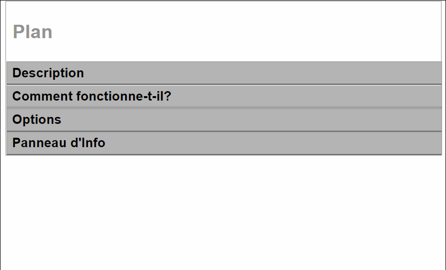

Finally got the French version of Info documentation to work.
I used Planar from the Construct2 as an example.
Lesson 1, Create (or translate), a French version of Planar.html, and place the file in the FR folder under the nodeeditor Documentation folder.
Do NOT change the name Planar.html.
Lesson 2, (I could be mistaken, but:) Apparently Karsten's code does not utilize the MoI Option button language version.
So changing "EN" to "FR" in line 4 of lang.js was used to enable Info to access French version of Planar.html in the FR directory.
???This should be corrected by modifying the prototype.getExtraMenuOptions code??? to recognize the MoI language being used as per the Option button language version selection. (Somehow, I do not know how.)
(My French Planar.html file was just titled as a pretend translation.)

9518.9
Planar Info works fine...in English :)
In general just rename / double the folder "EN" in Folder "Fr" is not sufficient and of course the file HTML?
Keep the good work...
EDITED: 5 Oct 2019 by PILOU
9518.10
Here the file with French translation (i just make that)
http://moiscript.weebly.com/uploads/3/9/3/8/3938813/planar.html
Accents are possible not acceptable so just reload in your text editor and change the ANSI / UTF and resave...
(i tested on my web browers that works fine - accents are not good as preview with the system of loading for send...so normally no problem from the node Edtor if you succeess to call it :)
