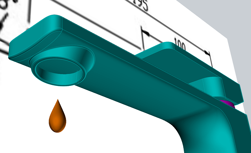

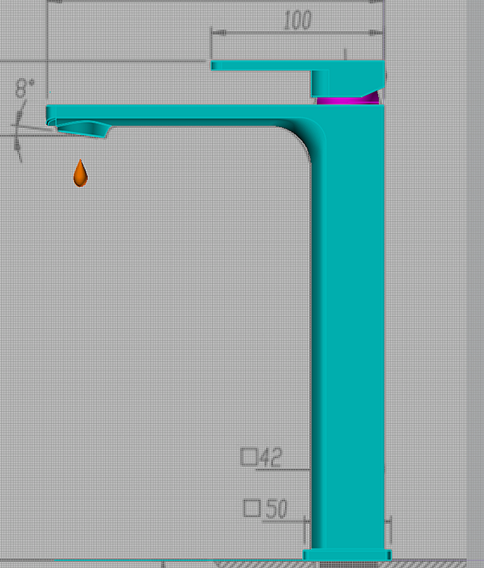

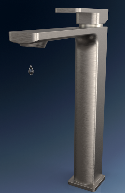

9478.4
EDIT: Here's my 2nd attempt. I was not happy with the front face in front of the aerator on the first attempt. New images uploaded below. Rendered in KeyShot.

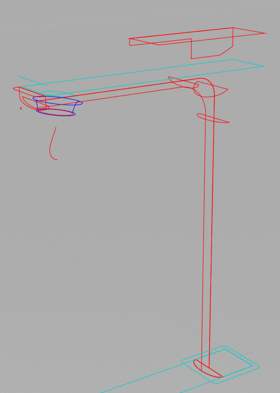

Hi Mik,
Could you please explain how you created this surface?
 From:  Mik (MIKULAS)
9478.6 In reply to 9478.5
Hi Stragazer,
I've used Network command together with set of curves.
Hope this helps.

 From:  neilwilson3412
9478.8 In reply to 9478.4
Hi Mik,
great job! and great explanation.love what you did in the complex curve area.
 From:  Mik (MIKULAS)
9478.9 In reply to 9478.8
Hi neilwilson3412,
thank you very much for your kind words.
I wasn't sure from attached photo, if front surface of mixer is flat or curved, but it seems from another photo https://www.sinkwarehouse.com.au/products/fiona-basin-mixer-black/, that surface is flat, therefore i decided to use that procedure, only as an exercise, but it exists more than one solution of course.

9478.10 In reply to 9478.9
"... but it seems from another photo https://www.sinkwarehouse.com.au/products/fiona-basin-mixer-black/, that surface is flat"
That's a much better photo and line drawing. On the original silver photo I was seeing slight curvatures, which made the front face more complex to model.
9478.11 In reply to 9478.10
well done ed!
sorry i didnt respond sooner!
the image is tough to see the under belly curvature. i will be having another go today.
