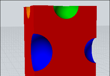

else i have a bug with the "sub-object" ?
9477.14
else does this normal ?
after boolean Diff of a blue sphere from a Red Cube i have the "generative arc circle" on the result ?
So 2 "facetts" on the result!

9477.16 In reply to 9477.14
That's a normal result if that was where the closing "seam" edge of the sphere was at.
9477.17 In reply to 9477.16
"Seam's sphere" yes it's :)
So i suppose to rotate it before boolean Diff can solve this little disturb...
else
I correct the "sub object bug" in pasting your "English script" inside the "ShortCut" Moi editor and change comments directly !
(even with accents)
That works! :) I had previously copy / past the text from another prog... maybe this explain that! :)
