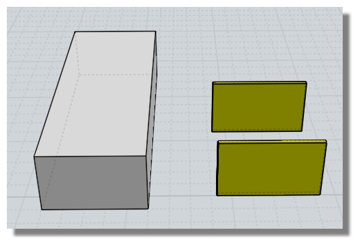

I can't erase these 2 green objects!
Seems they are some objects in the same place but curious that they can't be erased in only one pass ?

What do you mean you cannot delete them? I just deleted them after opening your file. At least those yellow objects selected in the image. :)) (I did not see any green objects).
Did you try to close the program and reload the file again and see if it's resolved?

And you right erase is working after reloading! But curious the big box is not living in this file!
A new mystery! :) Maybe result of the use of Elephant!
