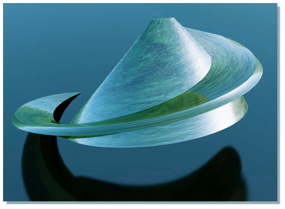

That is surrelely the more easy and funny render for Moi 3D and you can use it commercially!
""You can use Twinmotion to create stunning visualizations for any purpose—whether you’re a professional working in a commercial environment, a hobbyist working on a personal project, or a student or educator getting to grips with real-time design visualization.""
Don't forget to load it! :)
Huge library of material, vegetation etc...
A young boy or girl can use it because its User Interface is so easy!
No time to use it now due the ELEPHANT repository but 30 seconds from time to time for the fun! :)
From a moi Object (this one is render by simlab composer i don't refind the 3dm)
thx James for the node!
from a Moi's node
From a sketchUp object by Joe
EDITED: 10 Oct 2019 by PILOU
