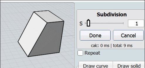

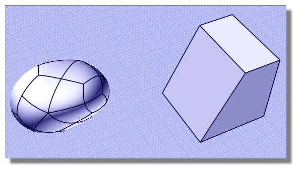

A good reason to use the subdiv function! ;)
A simple cube trimed : export as obj then apply the new SUBdiv from a file function of the beta V 4 ;)
You will obtain a lovely polished stone!
or with the old Subdiv by Max SMirnov
but careful with the old Max you can't make this following! (with the new function integrated of the betaV4 yes! ;)

Subdiv will work also with your start object but as it's not very adapted result will be not very suitable! :)
Depend of what do you want exactly and size of what is viewed! :)
With this yellow stone (yours subdivided post 1)
