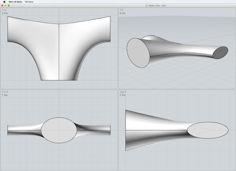

Here is a picture of the model:
hidden

1 - Where do you find the mp3 file inside the 3dm file?
2 - I'm curious how you modeled a knife edge into the 3 blending ovals? Tried to reproduce that and I get close but with a slight bubble on the Y-axis center seam surface. Tried sweeps, blend and network using the curves in your 3dm file.

Regarding the modeling i did that many years ago,
so i can't help that much, because i forgot the steps.
Only thing i remember is that i used also ViaCAD
for this model to get the proper N-Sided Surface
at the tail.
