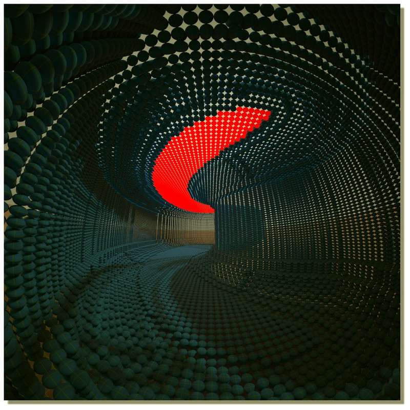

From an internal view...
Here each cubes i a Sphere!
Of course Magica can manage several Matrix of 126 ;)

Use the "Stereographic Projection" of the render with Grid and Edge rendering enable!
You can give Colors to the Edge and Grid!!! (here red edges & Gray grid)
BackGround is Blue, Ground is Yellow or any color you want...
And of course some different material that you want for the object's faces themselves!
Here just Glass Material!
You can explore in real time trough the objects like inside a sort of 3D univers depending of the Angle of the Stereographic Projection!
Best is taken 150° to 270° for have a some deformed view! ;)

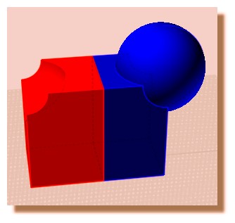

Exploring the functions of modeling :they are totally crazzy!
And you can use them inside the Console!
Here Select Face then Console ero xy then Clic Attach Face, Cut
