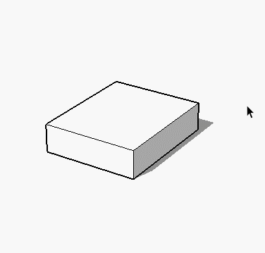

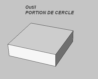

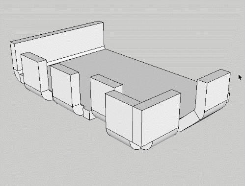

7406.24
In case of!
Remember there is a little free plugin for SKetchUp by Sdmitch : Sheet Metal Bender
http://sdmitch.blogspot.com
The last free version of Sketchup who can use Plugins is the SketchUp Make 2017 !
Curviloft by Fredo6
For something without "gorge" there is the native function!
EDITED: 27 Jun 2019 by PILOU
