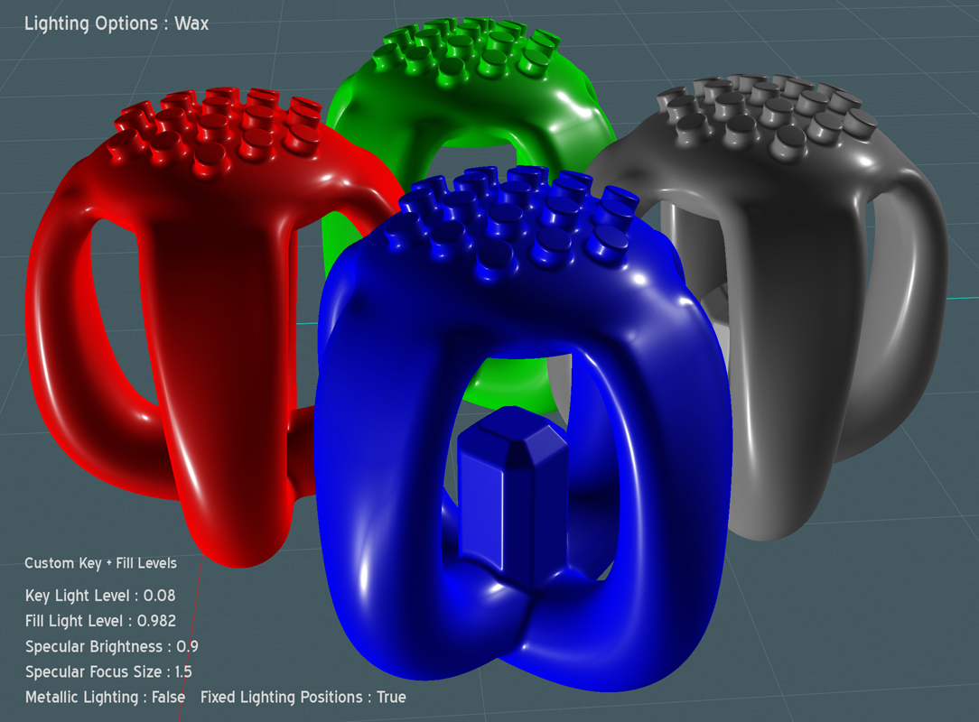

If you have the settings just right (like in the "Wax" example) it appears that there is some kind of room or effect that mimics ocular occlusion, or darker areas.

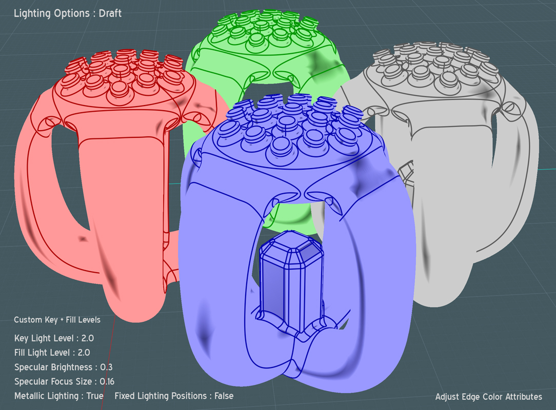

Below are some example of the different looks you can achieve just with a few easy tweaks.
I created this strange looking model shown for the purpose of reflecting the light sources in different ways.
It looks like some kind of crystal-powered back massager, but it was really just a free-form object using Sweeps, Blends and a Flow.

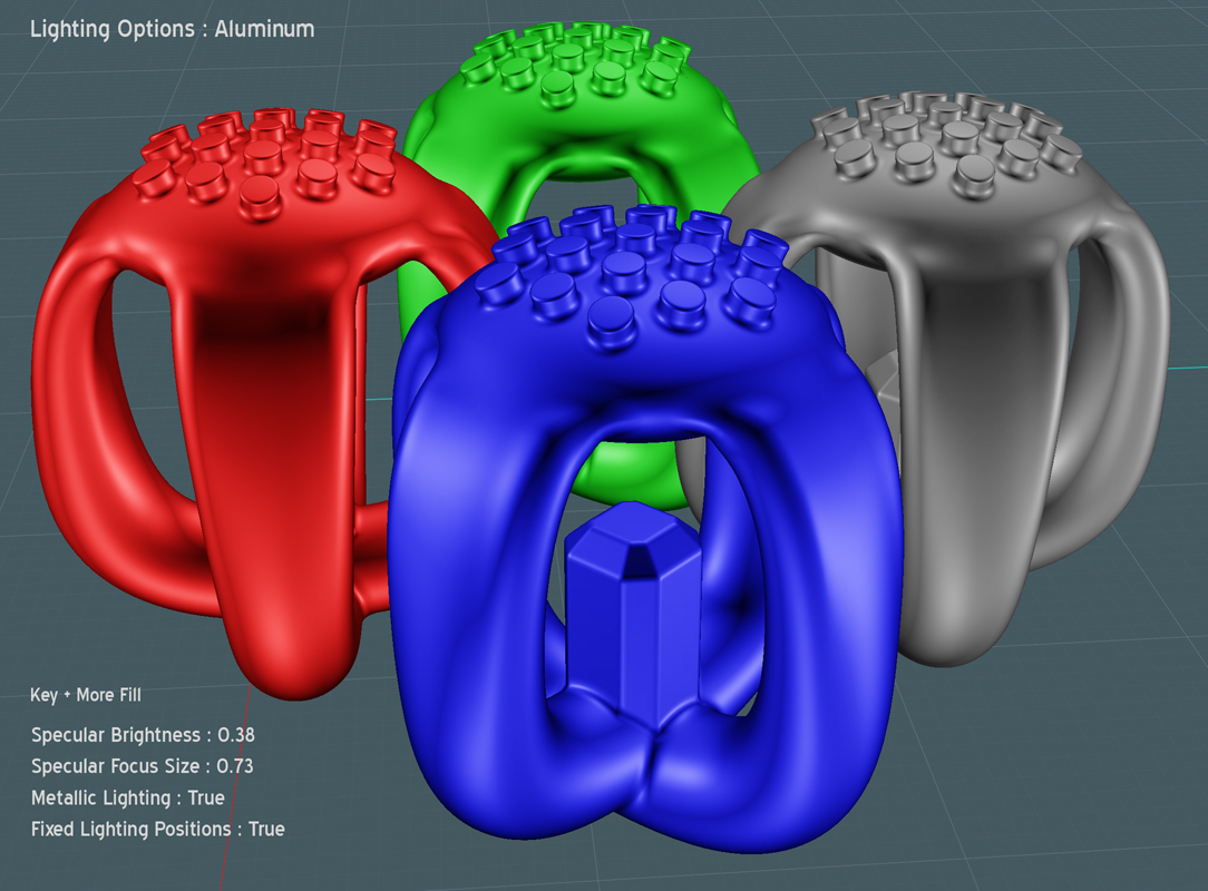

Here are my pre-made lighting combinations ::::
You can use Dino's script to access them when you wish, or program each mini-script (listed under pic) as a favorite key command.
Aluminum:
Lighting options for Aluminum - Script code:
script: /* Set lighting options for Aluminum */ var v = moi.view; v.lightingStyle = 'MoreFill'; v.specularHighlights = true; v.specularBrightness = 0.38; v.specularFocusSize = 0.73; v.metallicLighting = true; v.fixedLightPositions = true; v.customKeyLightLevel = 0.0; v.customFillLightLevel = 0.0;

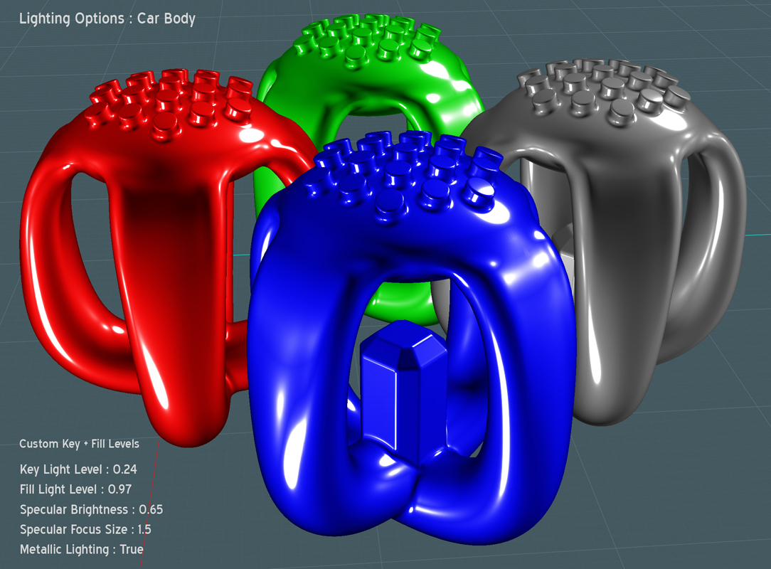

Car Body:
Lighting options for Car Body - Script code:
script: /* Set lighting options for Car Body */ var v = moi.view; v.lightingStyle = 'CustomLevels'; v.specularHighlights = true; v.specularBrightness = 0.65; v.specularFocusSize = 1.5; v.metallicLighting = true; v.fixedLightPositions = true; v.customKeyLightLevel = 0.24; v.customFillLightLevel = 0.97;

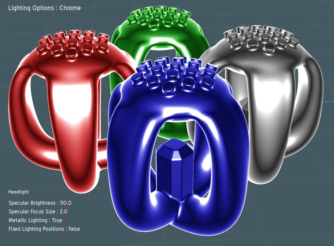

Chrome:
Lighting options for Chrome - Script code:
script: /* Set lighting options for Chrome */ var v = moi.view; v.lightingStyle = 'Headlight'; v.specularHighlights = true; v.specularBrightness = 50.0; v.specularFocusSize = 2.0; v.metallicLighting = true; v.fixedLightPositions = false; v.customKeyLightLevel = 0.0; v.customFillLightLevel = 0.0;

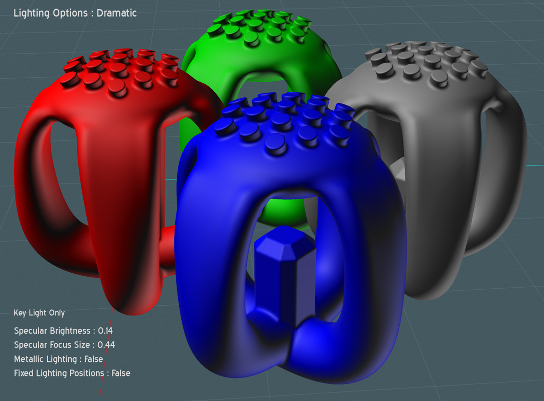

Dramatic:
Lighting options for Dramatic - Script code:
script: /* Set lighting options for Dramatic */ var v = moi.view; v.lightingStyle = 'KeyOnly'; v.specularHighlights = true; v.specularBrightness = 0.14; v.specularFocusSize = 0.44; v.metallicLighting = false; v.fixedLightPositions = false; v.customKeyLightLevel = 0.0; v.customFillLightLevel = 0.0;

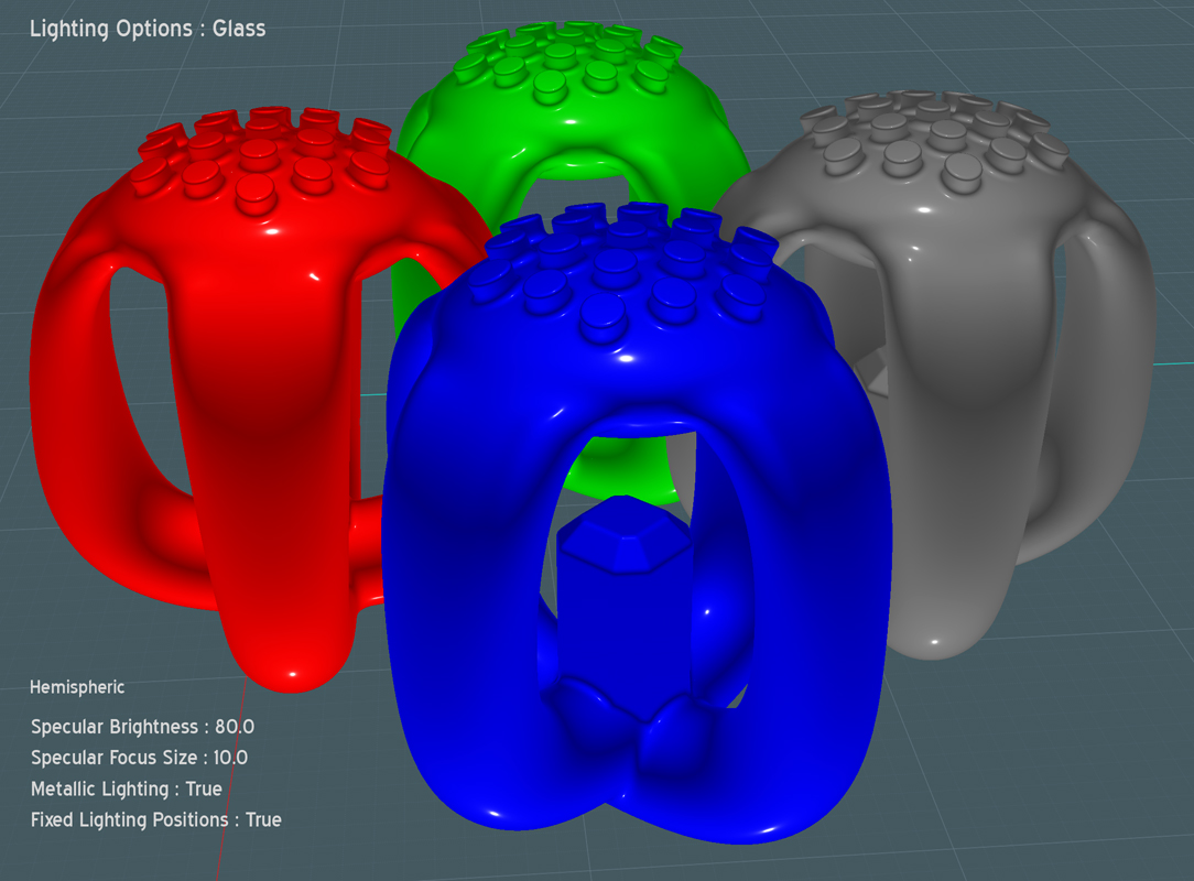

Glass:
Lighting options for Glass - Script code:
script: /* Set lighting options for Glass */ var v = moi.view; v.lightingStyle = 'Hemispheric'; v.specularHighlights = true; v.specularBrightness = 80.0; v.specularFocusSize = 10.0; v.metallicLighting = true; v.fixedLightPositions = true; v.customKeyLightLevel = 0.0; v.customFillLightLevel = 0.0;

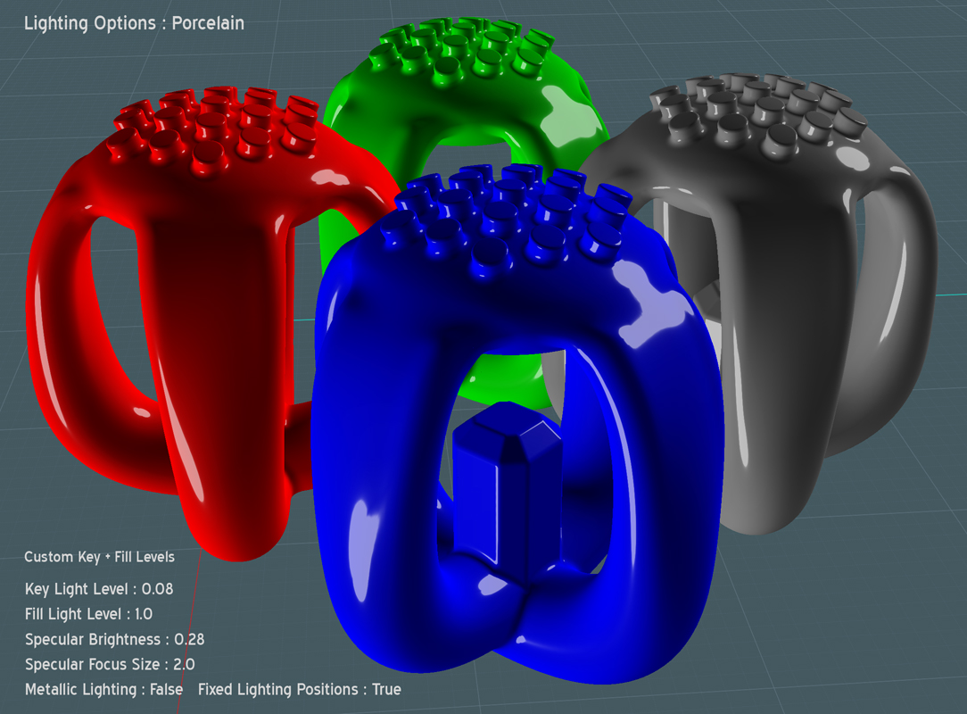

Porcelain:
Lighting options for Porcelain - Script code:
script: /* Set lighting options for Porcelain */ var v = moi.view; v.lightingStyle = 'CustomLevels'; v.specularHighlights = true; v.specularBrightness = 0.28; v.specularFocusSize = 2.0; v.metallicLighting = false; v.fixedLightPositions = true; v.customKeyLightLevel = 0.08; v.customFillLightLevel = 1.0;

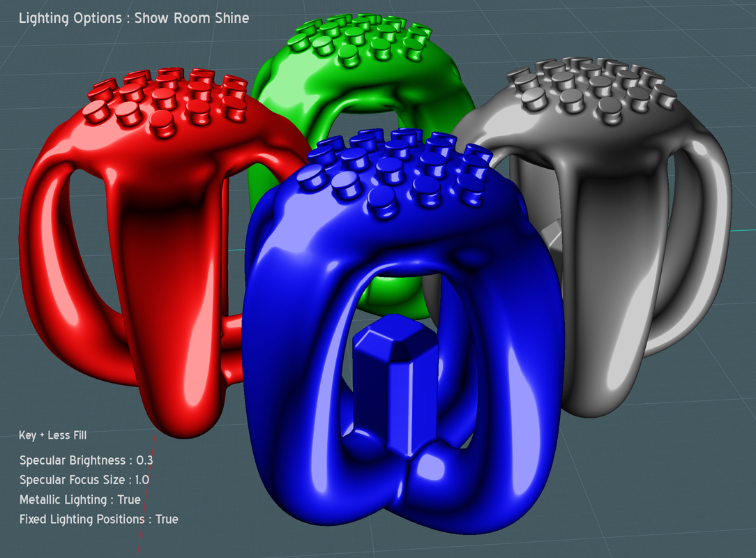

Showroom Shine:
Lighting options for Showroom Shine - Script code:
script: /* Set lighting options for Showroom Shine */ var v = moi.view; v.lightingStyle = 'LessFill'; v.specularHighlights = true; v.specularBrightness = 0.3; v.specularFocusSize = 1.0; v.metallicLighting = true; v.fixedLightPositions = true; v.customKeyLightLevel = 0.0; v.customFillLightLevel = 0.0;
Wax:
Lighting options for Wax - Script code:
script: /* Set lighting options for Wax */ var v = moi.view; v.lightingStyle = 'CustomLevels'; v.specularHighlights = true; v.specularBrightness = 0.9; v.specularFocusSize = 1.5; v.metallicLighting = false; v.fixedLightPositions = true; v.customKeyLightLevel = 0.08; v.customFillLightLevel = 0.982;

A simple solid shading with no specular or shadows. Used for applications where a (high pixel size) screen capture of the Moi view port can be Color Ranged in Photoshop or vector auto-traced in a layout program like CorelDRAW or Illustrator.
I will often create 3-D type or basic objects to be used in my graphic design, assigning unique color values to the sides and faces.
(Moi screen capture, auto-traced in vector layout program and assigned fills and outline strokes.)
For more complex graphics requiring edge detail I prefer to use Moi's PDF export feature, but PDF export does not (cannot) produce clean solid representative closed vector (EPS) faces that are view-dependent. This method has been a quick solution, and all that's required is to us Moi's screen capture script set for higher pixel dimensions.
