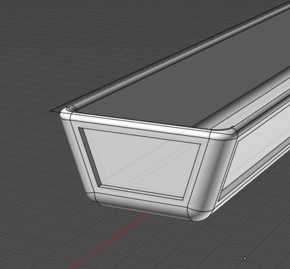

Can someone help me understand why I cannot inset 1mm in the ends of this item, but I can on the longer sides?

Maybe because angles are not 90° ?

agh, that makes sense (and unfortunate for me).
Thanks!
edit: I guess I'm doing it "the old fashioned way"!

I'm not sure about the reason of this, but I tried "ShrinkTrimmedSrf" command on your object and that fixed it.
Select your object, press TAB, paste "ShrinkTrimmedSrf" and press Enter.
