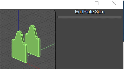

This is a problem that I ran into in the latest Beta. On the part shown in the front, I am
not able to select the face with the red dot. And I tried this from different viewing angles.
After duplicating the part and applying the shoulder fillets (acis), I am able to select the face.
But now I can't select the two little faces with the red dots. Loading the part in V4 does not
give me these issues, everything works as expected.
Just wondering if someone else has the same problems? Besides the screen shot, I attached the
moi file as well.
Ad

11074.4 In reply to 11074.1
Hi Ad, I'm not able to repeat the selection failure here either.
Does it still happen for you if you reload that file?

11074.6 In reply to 11074.4
Closing Moi and starting with a new session does not change anything. I also tried the previous Beta,
I think April 8?, same thing. V4 no problem at all, works just like expected.
I also tried if it makes a difference if I delete the face, which required me to delete the opposite face
first in order to select the front face from the back. I just copied the back face before deleting and then
pasted back in place. Also duplicated the face from the back to the front and joined everything to get a solid.
I may have tried some other steps, anyway in the end I was able to select the front face, but not the back.
I actually first tried to recreate the back face by coping the edge loop and then create planar from that,
but the edge loop selection (by script) went kind of haywire, it did not go around like I thought it would, so I did
the copy and paste thing. Maybe it does not work on open faces?
Almost seems like there is surface normal issue in my case, since I can select the face from the back but
not from the front. But I am just guessing here. And this is running under Wine. Just not sure what changed from
V4 to V5. Otherwise everything works fine, so far, and Moi seems to be more responsive than before, but it was good
before.
